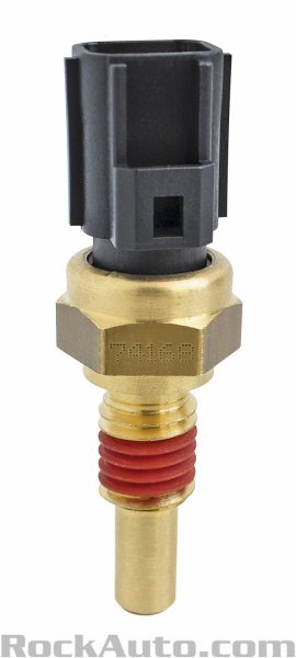

You can pull the alternator out of the way and replace the temp sensor. That's the most likely culprit. It's a pretty common part. You can find one at any NAPA store.
Here's a YouTube video on the temp sensor replacement job....

Yea bet a hundred bucks it’s the temp sending unit. Thanks to Hamfisted for putting up a vid....
