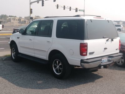

Hey all.
Donny K here in SE Washington State.
Got a White Rhino 1998 XLT AWD 4.6L
Just got it back from Jamco, who had it the last 8 mos while I scrounged up $3,550 to
get him released. Yep, it's a him, 'cause it don't smell like a her!
Anyway, he's mine now and with a rebuilt tranny to boot. I think I'm lucky I didn't have to drive through the snow this winter but then again, it just sat for 8 mos! So, it has some issues but, I'm confident I can get it back on the right track.
