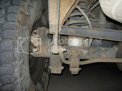

Yup... I have the 2 inch metal ones.... awesome cheap mod.... like KWT said. See if you can borrow a spring compressor from someone to make it a little easier on you.
I believe you can put them on top of the springs, but I put mine under. Quick pic for you so you know wht you are looking for if you want to go metal...
