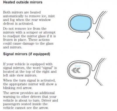

The function for turning on the heat is controlled by the climate control system.
Did it change from 98 to 99. My 98 manual say's the heated mirrors turn on with the rear defroster.
