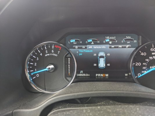

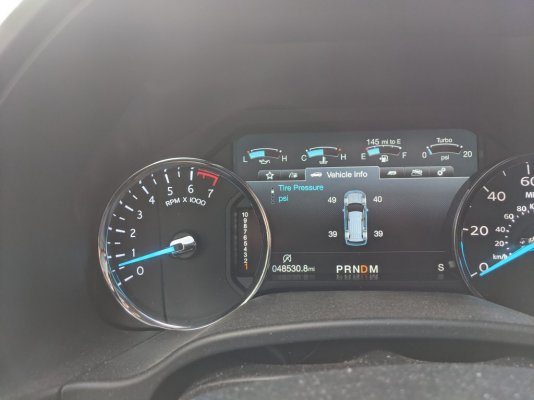

Glad I searched for TPMS before posting... I just got a new set of tires. On the way home, I wondered, "How much pressure did they put in?". At a stop light I checked and couldn't believe my eyes: 3 @ ~40psi and 1 @ ~50!. Puzzled, I left the display on that screen and continued home.
Then all of a sudden, my 50lb front right jumped to the left!
I checked at home and confirmed the front left was the high one. The car auto learns!
If you are curious, I run 22s and set them all to about 48psi. Checked the display afterward and two were 46 and one 47. Close enough.
