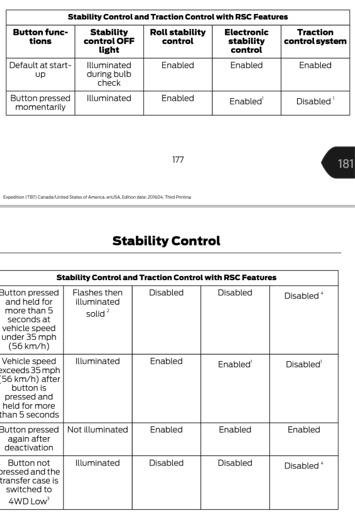

There are 2 completely different systems controlled by the same button. Based on your picture, both are off it looks like.
Both are off in 4L, but in 4A/4H they are controlled by how long you press the button.
With Both on or Traction off but stability still on the Truck should fight you if you try to do donuts. It should try to bring the vehicle in line.
Here is the chart out of the owners manual:

Agreed, but with Stability control engaged, it would not let me do Donuts in my 17. It would brake the wheels to bring it back in line. Take stability control off and yep, all day long especially when LS stepped in!
