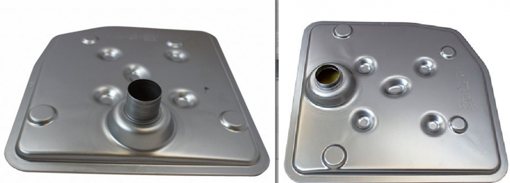

I can't figure out where I bought my trans filter, I haven't done the trans service yet as i'm waiting until after I complete my timing job.
so my question is this, did I screw up by getting the motorcraft/ford filter which is all black and has a long pickup tube with an orange-ish gasket on the top of the tube??
i'm a little confused and having doubts now cause when I look on the ford dealer parts website, it literally shows two different pictures with two slightly different looking filters, but it is on the same product listing/page.

If you installed the long-tube you’ll be fine.
This DOES explain why some people have filter clearance issues when switching to the Dorman 6r80 trans pan with the drain bolt.

i'm such a dummy, the two pictures is because it shows the bottom side and top side, the black side with long tube on top and the short spout with un-finished side for bottom.
