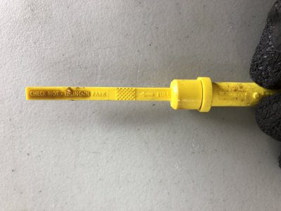

Removed the bolt to check the fluid level and the dipstick is broken... Don’t believe it broke in the process of loosening the bolt

Purchased a new dipstick and plug from local Ford dealer. After having the engine off for a few minutes, I started to remove the old plug and broken dipstick. As I was loosening the bolt, transmission fluid begun to seep out and I tightened it back up and waited for the fluid to cool down and contract. I was then able to get the bolt off without liquid coming out. Since the engine was off for about 15 minutes, I checked the transmission fluid level with the new dipstick and the entire dipstick was covered in liquid - up to the end of the dipstick where it makes contact and rests on the transmission case.
Since you are supposed to check the level at operating temperature and while the engine is at idle, how is it possible for the fluid level to basically overflow a few minutes after the engine is off with a transmission that has never been serviced?

I believe that when the main transmission pump is operating (engine on), that the pan fluid level drops somewhat, due to the fluid being pumped through the transmission. When the engine is shut-off, the pan fluid level increases as the fluid flows back to the pan.
6,530
3,140
You are correct, engine on fluid is being sucked up and circulated. Once it’s turned off it all settles into the pan.

I checked the fluid level this morning with a cold transmission/engine (going by FordTechMakuloco’s instructions for checking a cold transmission level) and the transmission fluid is still up to the end of the dipstick. Should I remove any fluid?

No,do not remove any fluid. Do as the dipstick says and check fluid hot and at idle. You may actually have to add some. As for the clunking on downshift,my shop Ford foreman buddy did a tcm reburn and it went away on my 07. Known issue,i believe he said there's a service bulletin for it.

Checked the level at operating temp at idle - level is low. I’ll pick up a quart of Mercon SP today.
To save some time, does anyone know how much fluid I should add to get it into the full area?
