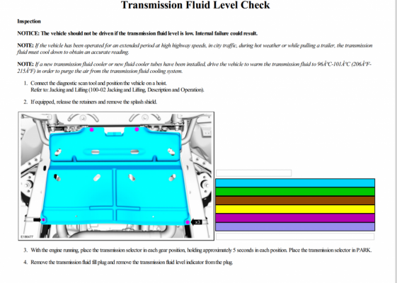

So you say it is overfilled and I should drain some? Why would the dealership overfill 2x?
I assume you are measuring with the engine idling at operating temps.
I am not sure it is overfilled, there are several dipsticks and yours is different than the one in the attached file. I will post the instructions for different dipsticks later today.
The main issue with technicians overfilling it is that the level has to be checked when the temp of the fluid is 205 deg. This requires the technician to drive it for probably an hour to reach this temp. Plus, the dipstick is very close to the hot exhaust which will get you for sure.
The technicians take a shortcut by filling when cold to the bottom of the acceptable range on the hope that the level will be OK when the fluid expands. Unfortunately, with this particular transmission, this procedure results in one quart overfilled transmission (don’t ask how I know haha).

I think if you were able to reach the dipstick yourself, you should buy a $10 fluid extractor and pump some fluid out. Do increments of 0.25 quarts until you are at the correct level.
If you leave it alone, it will puke it again in the middle of a long drive.
