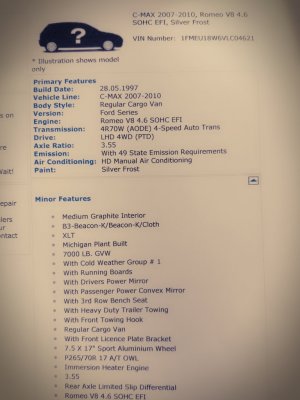

I have just purchased a 2002 XLT with 60k Miles in pristine condition. The only thing on it that didn't work were the electric mirrors. I fixed that yesterday by cleaning the corrosion off the switch mechanism. I was trying to find which options I had so I used the etis lookup. at first it said it couldn't find the VIN but then it displayed "recent VINs". when I clicked on that it brought up this "C-MAX 2007-2010, Romeo V8 4.6 SOHC EFI, Oxford White". By going through the list I see I have what is on the list. Just puzzled by the 2007-2010. Anyway, thanks again. Forums are a great resource.

Had that too when I looked up my older Ex. Color and vin was right plus accessories but not make or year

Same thing happened to me the other day as well. I was trying to figure out my own vehicle. I used the site about 6 months back, and it worked as it should, but something is definitely wrong with the site.
