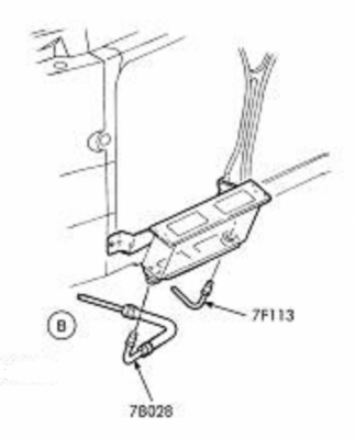

You may already have a transmission factory cooler and a large pan. 4R100 is a robust, high mile truck unit. Local transmission shop, serviced mine at 80K. They dropped pan, filter and drained converter(I watched). The dipstick plug was still in pan and bottom of pan was clean. Ford dealers, back flush, with a machine. I am not the original owner, but am pretty sure it was flushed. The transmission shop owner(honest guy), said frequent changes, not needed, unless towing. My dip stick tube was rotted out(engine tube also went,WTF Ford?). The shop was able to do a temp patch, to refill it. They lines were still intact, but crusty. I saw a co-worker leave a trail of fluid, in his, so mine got changed . The lines will seep and drip, then blow out, catastrophic failure(check them).
