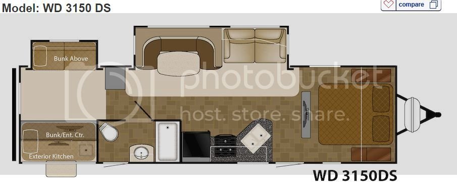

I’m a new member here and need to run something by the community. I recently bought new 35ft travel trailer and towing it with 2011 Expedition EL limited. The trailer is Wilderness 3150DS. The dealer installed a Equalizer hitch for me but I don’t think it was setup properly. I had about 3” squat in the rear axle and had some sway issues on the way home from the dealer. I did some adjustments on the hitch and would like to get some opinions.
