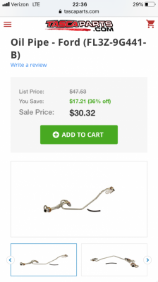

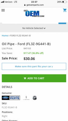

I wasn't looking for your invoice as I am not questioning the fix you received. I just googled the part number you mentioned out of my own curiosity and found it odd that it was a discontinued part number for a part used on 2016-2018 EXPY and Transit models. Was wondering if I needed such a fix in the future - whether that part would be available for my truck. Glad you got your rig fixed. Good luck with it.
Idk what you’re looking at but I can buy it right now on both Tasca and gotoemparts.com
