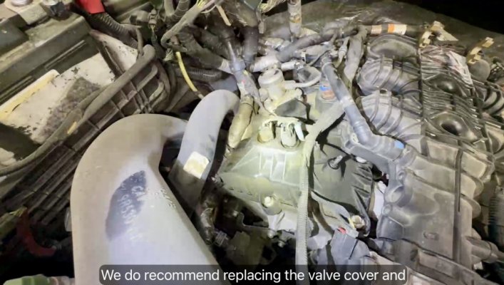

Valve cover leaking. $843 to. Fix it.

Depends on how bad the leak is. Is it dripping on anything hot? Are you running low on oil between changes?

If you can do your own work, it will cost you $25 and maybe four hours' time. And maybe $40 for a sensor you may break.
