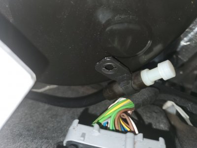

I am guessing this is the vent tube for the front differential.
My tube is just floating around on the break booster, I see a mounting clip around the tube to secure it to the teuck somewhere.
Can someone take a photo of where their tube is mounted.
I am not seeing where it should go.

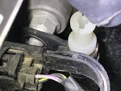

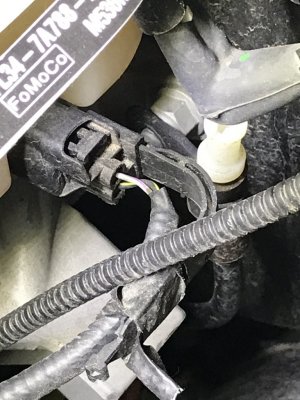

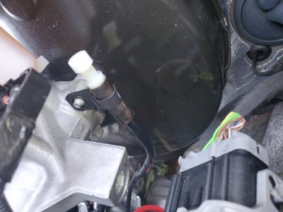

Mine is mounted on the stud on the brake booster as shown in the photos.
