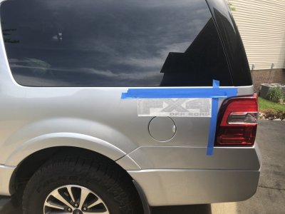

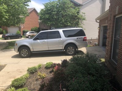

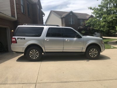

So I did this today. The jury is still out on whether it will stay. I like it from certain angles and others not so much.
The OEM ones only come with the red FX. I do not like red much at all. Found these “Ford Officially Licensed” ones in black and silver. It is the appropriate font for the corresponding F150 model year.
