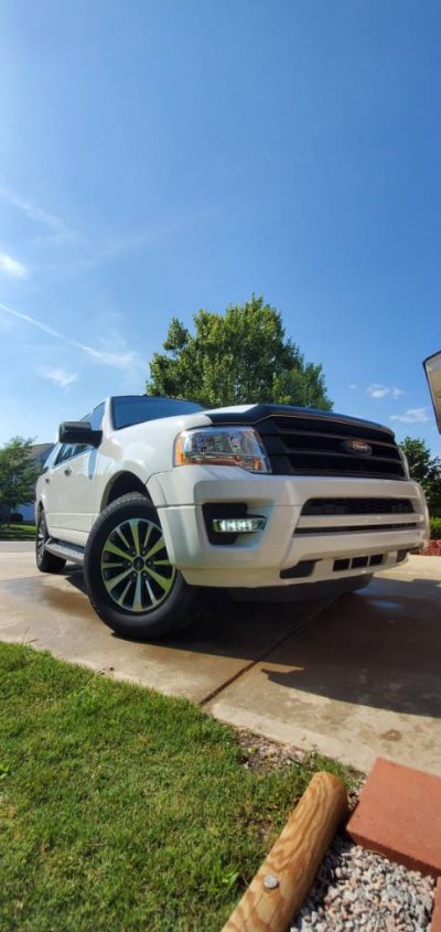

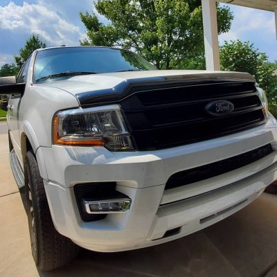

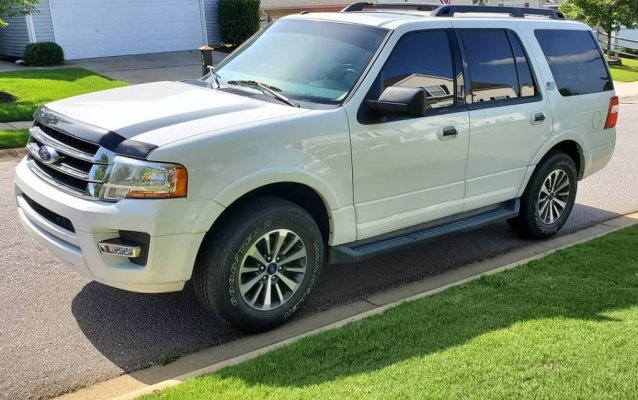

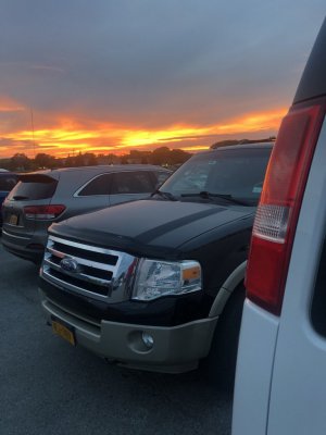

Thank you! It's the little details that count.That really looks sharp....nicely done!
Gotta hit the chrome on the fogs next.
Oh yeah for sure.Gotta hit the chrome on the fogs next.

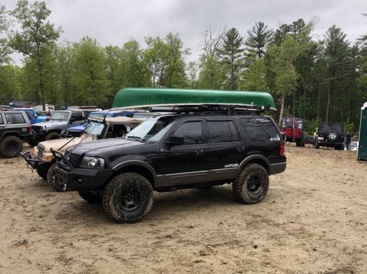

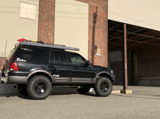

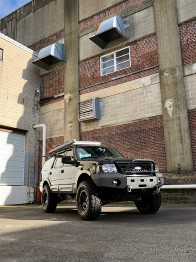

What front bumper is that! Asking for a friend of course..

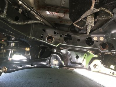

There’s a couple more pics, and the truck still has independent suspension all around and has a 3.5”/2.5” suspension lift kit with heavy duty springs and a 1.5” body lift. So about 5” and that and the custom and a little trimming I clear the 37s easy, also has 4.56 gears and a built billet tranny.
That roof rack came from Yakima, it’s called megawarrior and it has one extension on it.
In the near future it will have a 4.75” F150 lift in the front and further in the future it will be straight axle swapped in the rear to either a GM 14 bolt with 6 lug hubs or just a 9.75 open diff out of an F150.

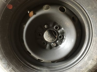

Its actually plastidip.What did you use? Looks good!
