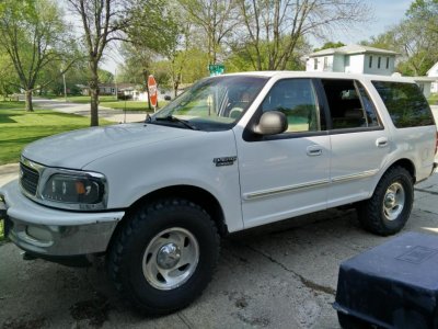

I fit 35's on my expy and all I had to do was trim my lower valance. I do have rear coil springs though.
