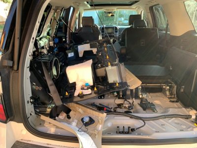

I'm starting a little build log of some upgrades to the 2019 Expedition Platinum I just picked up... Hopefully it finds it useful.
I haven't really decided how far I want to go, but I I know I want to keep the factory Sync3 interface. I'm not digging into the dash.
The B&O is all in the back left panels of the cargo area. There's a product by Nav-TV called a "Zen" that is one of the few integration adapters for the newer Fords that have the digital signal back to the processor. I pinged them about the Expedition because their site says it works. However, they haven't had someone integrate yet, and couldn't commit. I'm working with them to hopefully figure out if it will.
That being said - I just wanted to pull the cargo panels back to see what's back there.
Just a little start. You want that panel to come off, you are removing the back storage tray, c and d pillar panels, and more. It's kind of a pain. but you have decent access back there. The third row seating does NOT need to come out.

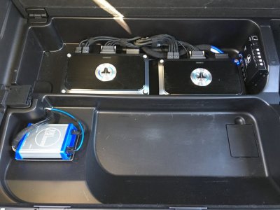

I did a complete audio upgrade on my 2018 back in September.
Took out the all of the B&O components and replaced them with the Nav-TV Zen A2B, JL amps and speakers. It sounds good but not great especially when compared to my 2007 Suburban with a Kenwood Excelon head unit.
I used a highly reputable car audio installer to upgrade the system and it took them 17 days!
Hindsight being 20/20 I would probably wait for something like the AmpPRO or some other interface that doesn’t require taking out the factory amp.
Keep in mind that no matter what you do if you keep the Sync 3 you are not going to get as good of an output signal as say a Kenwood head unit.
Super cool to see the Nav-TV Zen unit works. It does force you to replace the amp all up, but did you have any issues with the zen unit? You got all the channels output? Are you wired into a DSP with a built in EQ, or just straight out to the amps? Using a DSP will go a long way for tuning.

The DSP’s do help but the root of the problem is the SYNC 3. If you do decide to install the Zen A2B be sure and order an extension cable from Nav-TV so that you can place the unit where it is readily accessible. You will need to access this unit for the initial programming and periodic updates, don’t just run a usb cable from the unit. You must ground to the battery, very important! As previously mentioned, I had my system installed by one of the top car stereo shops in the DFW area and it took them 17 days, many of which were spent on the phone with Nav-TV getting the programming correct for the Expedition. If I had to do it all over again considering the money spent and the improvement gained I wouldn’t do it.
