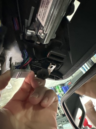

Welp, all done.
There are four clips, which I hope the photos show well. I used a relatively wide trim tool.
It seems that the far left and far right clips are the ones you have to pop out first, then the two center-most ones will follow when you pull it off.
Turns out that what appears like a speaker grill in the center is actually venting for the Windshield camera (lane departure assist?) and there are several wiring connections, some pass-through, for the passenger airbag indicator, the overhead controls for lighting/moonroof/etc, what I presume is the windshield rain sensor, the camera, and of course the auto-dimming mirror.

The front camera is mounted behind the mirror; it is actually in the first photo above, you just can’t see it.
The rear camera was mounted at the top of the rear glass on the lift gate/hatch.

Welp, all done.
View attachment 79403View attachment 79404View attachment 79405View attachment 79406
This picture helped so much. I’m always hesitant pulling on plastic. Was trying to install a wire tap for radar detector!
