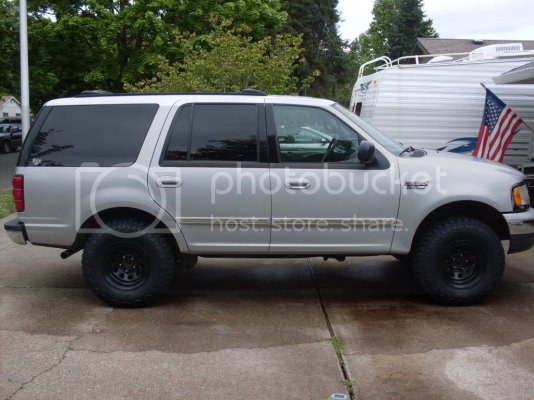

Here's a pic of mine with 285-75-16 (33-12.5-16) at stock height with no running boards, very little rub even off road at full flex

o nvy thats wht size im thinking about getting next time. hopefully i get a job like i keep saying and then ill get some mts to put on. a side shot of that would be great too. i know im repeating. sry. just want to see what mine would look like.

Thanks, you too!!
I would love to go bigger, but as we all know, that opens a whole can of worms as far as gearing goes. I tow a toy hauler and the gearing even on these tires is not great. So like a grand for gearing, a grand for 2" spacers, torsion twist, alignment, and BL to fit 35s" Seems a lot for 1" extra ground clearance. Plus, I've already come close to tipping this thing over on the trail and the higher COG would not be beneficial!!

damn hardcharger! you almost tipped it? yeah, maybe you shouldnt go higher! hahhaha. looks good as she sits. maybe throw some 4.10's in there to help with the towing.

that looks nice. now i need a spacer in the rear and those tires. unless i can go bigger.
