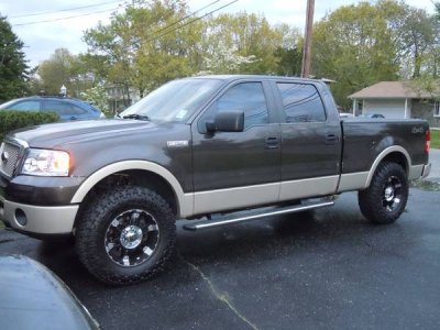

Need tires and for the price I can get tires for plus a few hundred I can have the attached wheel and tire package. I am curious however if this set up will fit a 03 EB with a 2 in. level, the tire specs are LT 295/70R18 on XD Spy's. Anyone use this size without issue? Yes I do know I will have to cut the inner fenderwell plastic. Thanks in advance. The Guy had them on the pictured 2010 F150 and all He did was cut the inner plastic and used a 2 inch level.

Like it says in the text: LT 295/70R18 on XD Spy's. The Guy says the tires stuck out barely an inch past the fender. I ask all this because I did "Think" that the Expy and F150 were the SAME in the front body wise, but low and behold the distance from the bottom of the fender in front to back is WAY more narrow (less tire) then the F150.

NM I just found a local Guy with this set up on an Expy and He said all He did was trim the apron, thanks to all again!! If I get these wheels and tires Ill post the pics.
