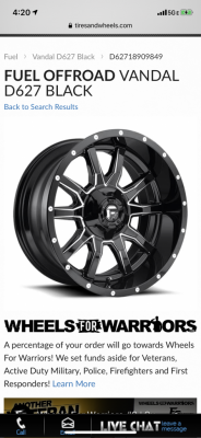

Let’s see some STOCK HEIGHT or a front leveling kit rides with aftermarket wheels. I’m looking at maybe getting these in 20” (possibly 18”) Please only stock or front leveling kits only. I’m not going to lift mine and doubt I’ll level the front but I may. Too much rust under it from the north to mess with that.

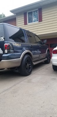

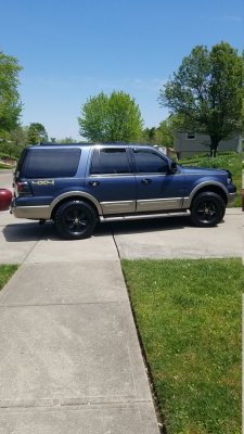

2.5 inch front leveling, nothing back 17x7.5 2015 F-15O take off rims with 285/70/17 all terrain tires. 2.5 inch spacers all the way round also!JPEG_20200513_130250.jpg 20200513_200031.jpg 20200513_200014.jpg

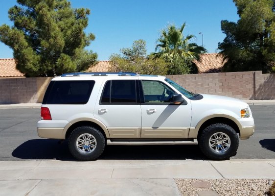

I'm thinking of mounting the Level 8 Slam (pictured) wheel with BFG 285s. They definitely rub the front bumper, so I am working on getting that figured out (will post on that in a minute). For now, here is a photo or two. But remember, I either need to lift or cut to make this package work. Good luck. I had a heck of a time coming up with wheels that would work with my expy due to the older bolt pattern. These Slams are 17 x 8.5 in with a -24mm offset. They fill but don't really poke out-surprisingly.

I like it bro alot also how did you remove your running boards I'd like to do the same. Wish I could've actually gotten 33s but my 285s are equal to 33s just about an inch or so narrower
Thanks man. The running boards are pretty easy to remove, you shouldn't have any problems.
