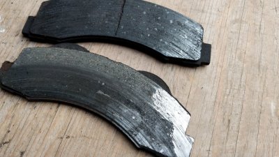

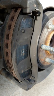

I decided to leave my brakes for after my trip. Guess what? While in Canada, the brakes started grinding. Not the warning sound but the bad sound. Never heard any "warning" squeal. The wheel even made a noise just while rolling, so I started to worry about wheel bearings. I bought pads at Canadian Tire and replaced them in about an hour! Easy, peasy! All I needed was a 13mm wrench.
Turns out, the inside pad was worn down more than the outside. It had just gone to the metal.
I google/youtubed the process even though I've done lots of brake pad jobs before. I was surprised that no pads came off with the caliper, and nothing really held them in place - other than the caliper itself. I did not see a youtube video that showed it like this.
I bought the cheaper set available (70 CDN including PST and GST, roughly $52) and did not replace the rotors.
I'll give it a bit and maybe do both rotors and pads, going ceramic possibly, depending on what y'all say.

The fact that the inner pad wore out way before the other, and only on one side, leads to a sticky caliper piston. Your going to want to replace both calipers when you finally do the full job. Shame to waste a new set of pads/rotor if you don't.

The fact that the inner pad wore out way before the other, and only on one side, leads to a sticky caliper piston. You're going to want to replace both calipers when you finally do the full job. Shame to waste a new set of pads/rotor if you don't.
I was going to ask about that. That side can't even be braking evenly, can it? This is more of a big job, I guess. I can't recall how the calipers are attached. Will involve bleeding, which I've done before... but it's been awhile.
Automatically replace caliper? Both calipers? Is there any chance the problem is just the slider pins not lubricated at last brake job? Thats why I like to do my own brakes, take that apart, inspect rubber boots and whatever, lubricate, file down brake pad's so no binding, etc. I'm not claiming to be a master mechanic.
