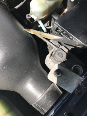

postings about oil and consumption on these 5.4’s. I’m watching my oil consumption more than my gas mileage I noticed on this trip since I drove at 75mph for the first 12-14 hour leg that I used 1/2 qt. The oil was at the lower dot that says minimum so I added to the mid way point or a little above middle between minimum and maximum dots.
On the second leg which was 7-8 hr run I really hit it w cruise control at 80 mph w some sprints to 90 mph. On this leg no oil was consumed at all. See pic.
The pic is AFTER the second leg. No oil consumption.
Where did oil from the first leg go? What happens to the oil that’s “consumed “?

Any oil that passes by the rings gets burned with the fuel and winds up in the exhaust. The PCV handles any raw or burned fuel (exhaust blown by the rings) that gets into the crankcase. It effects a vacuum in the crankcase and sucks the vapors back into the intake to be burned.
Got it. This makes sense to the relationship between oil consumption and piston/cylinder (compression).
This makes me feel good about the condition of the motor and indicates I have good compression.
Only having used 1/2 quart on this run after 1100 miles of constant highway through hills and Tennessee mountains and into this 90 degree heat in Fl.
Couple weeks ago on my last run I used almost a full quart, but I drive harder. Wonder what my oil consumption would be if I drove more like Ms Daisy @ 55mph and a max of 70 mph.
