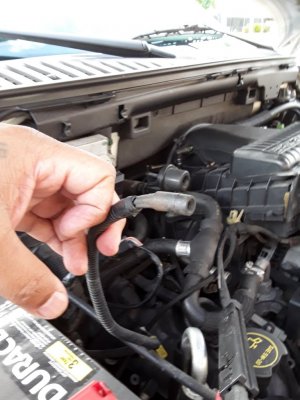

Where does this wire go?
Vdevice
Apr 18, 2019
Cape Coral FL
Hi all, need some help finding where this wire attaches too. The first pic shows it coming out of the rear firewall. And the next two shows the wire.
TobyU
Apr 5, 2013
2,479
869
Ohio
It's a vacuum hose and goes on the small port in the middle of the heater control valve in the heater hose right below the green ground bolt in the pic.
