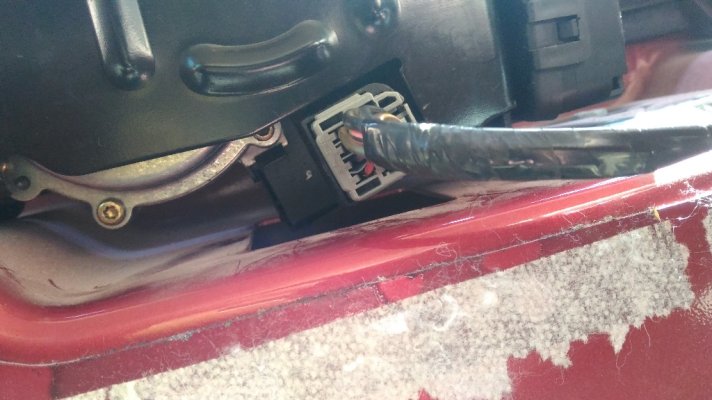

Okay, so today I took apart the back door! Well, the trim at least, it's kind of fun! What is NOT fun is the ******* fuse box placement, I managed to lose two fuses down in there, but, well, I managed to check fuse 1 and fuse 38 which are supposed to deal with the back wiper and since those are the ones I lost, they've been grudgingly replaced. Also, is it normal for fuse... 101, I think it was? to not have the plastic cover that all of the other pink boxy ones have?
Anyway, back door. So, I narrowed the clicking noise down to the motor itself, and once I took all the trim off (my back door isn't rusty at all, heh, unlike our poor 7 chrysler minivan) I narrowed it down even further to a small box hidden behind the wiper motor... every time it tries to cycle the motor, there's a click that comes from the box, unplugging the gray plug makes it stop, and after reseating it a few times nothing's changed.
Is the box some sort of control module for the back wiper, or something? Does it gotta be replaced again? Also, no, messing with the fuses didn't fix the dumb "low washer fluid" alert.

The clicking is most likely the motor. From your pics I would say that plug is connected directly to the wiper motor. The dealership most likely cleaned the wiper assembly and sent you on your way.
