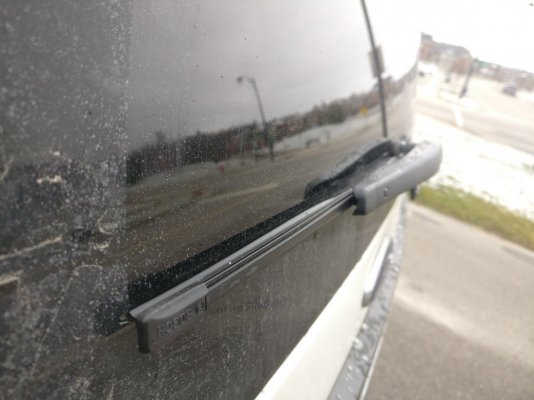

Hello everyone struggling to find the rear blade for our 15-17' years with crooked one-of-a-kind arm.
The Scrooge inside me resisted to pay a good coin to a dealer for it just because there are no over-the-corner aftermaket straight replacements.
Well, some hours down the road and I've found it!

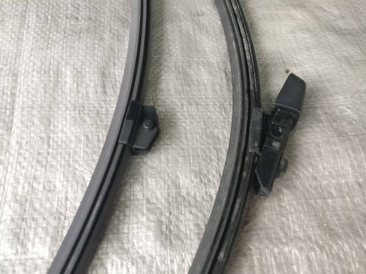

BOSCH A402H, 16 inch. The blade itself is 100% the same but you have to carefully detach the little plastic adapter from the original one and swap it. Easy done with a small flat screwdriver.
This wiper fits Audi A4-8 allroad, some qattros, Mercedes and even Bentley, so, I'm at 0.1% Bentley now, eh.
Easily sourceable from Amazon and NAPA, costed me twice less then the oem from motorcraft.
