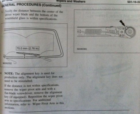

Ok - so I'm an idiot... the part I was seeing is an alignment key. It locks the arms to a preset factory position. If the arm needs to be adjusted outside of that default position, the key is to be removed. Just did that and now the arms are sitting right on the wiper heating elements!
Maybe this will help someone else someday.

I’m lost, if there is no key what makes the arm move?
There are still splined teeth all the way around. It’s just that the original wiper arms (before the recall) the factory had removed the key lugs. When I looked at the new arms (after the recall) all I noticed was the keys and thought “oh - that’s a totally different design” and put them back on.
^^THIS^^
Just to be clear, there were NO keys/lugs on my 011 OEM arms, nor on the replacements I ordered from da Rock, so it was merely a matter of pulling off the old ones (with a small "wheel-puller" tool) & installing the new ones, lining them up to the spot where I wanted them, gently tapping them down onto the splines with a small rubber mallet, screwing down the bolt & closing the top cover to finish the job...
