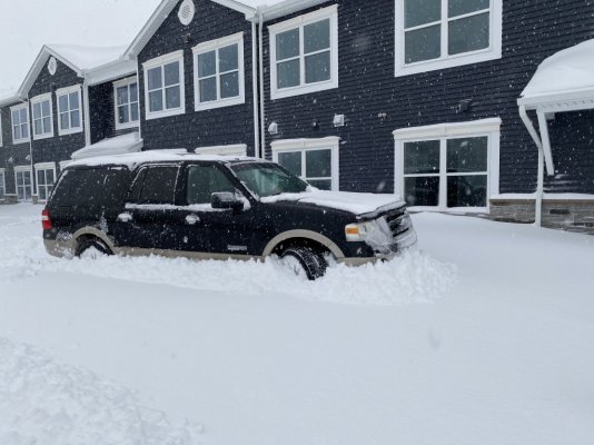

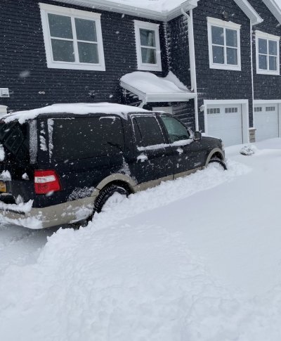

4WD with open diffs over a locker only any day agreed. 4WD will take you a lot further since it’s sending torque to 4 wheels albeit equally to the weakest link on each axle. A locker can only do 2 at differing torque. This was Monday in 2 feet of snow. I was not stuck in the least, plowed itself right in there and pulled right out after I checked on the furnaces in 4H. I have open diffs. This is where that heavy boat anchor 5.4 comes in handy….a hunk of cast iron weighting that front axle down works wonders when the going gets bad.
