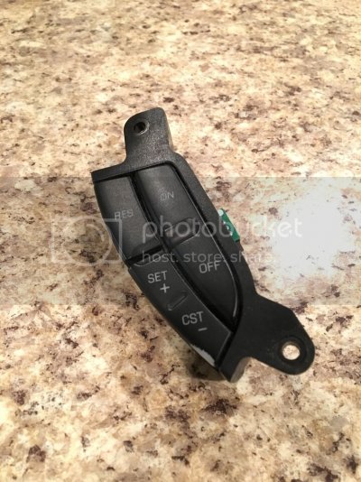

Referencing the cruise switch pod for this illustration:

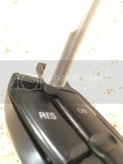

Torx driver pointed at one of the two points to access the screws that hold the board/switch assembly to the pod housing:

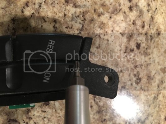

And with the bit on the actual screw it will look like this, just take your time the button will move a little to give room to get the bit inserted:

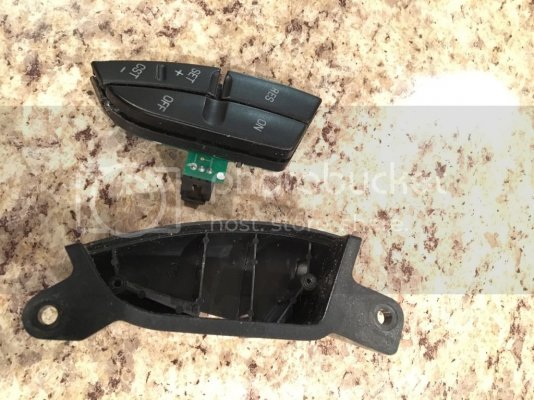

Do the same at the opposite end same spot to remove the other screw.

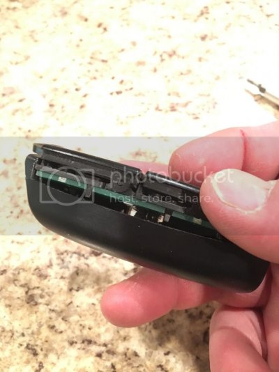

The screws will remain captured in their places. Gently lift the outer edge of the button/board assembly (opposite the plug), and you can remove it from the housing:

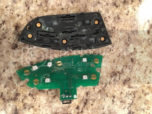

On the back side of the board you will see the clips that hold the button assembly to the board. Very gently lift on the board with one hand while releasing the tabs working your way around until it is separated:

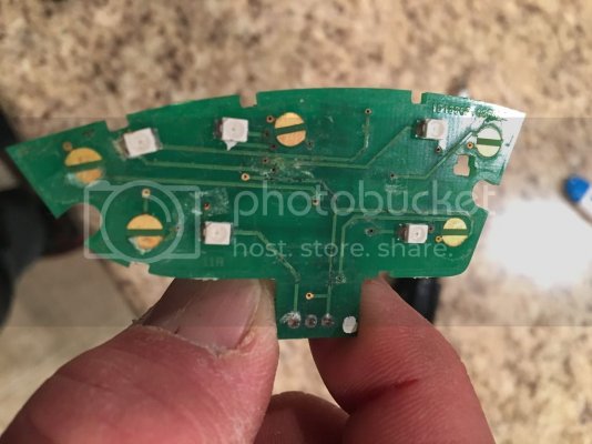

This picture shows the button contacts and the corresponding circuits on the board. The copper cylinder gets pressed into the two contact patches on the board when you push a button, completing the circuit.

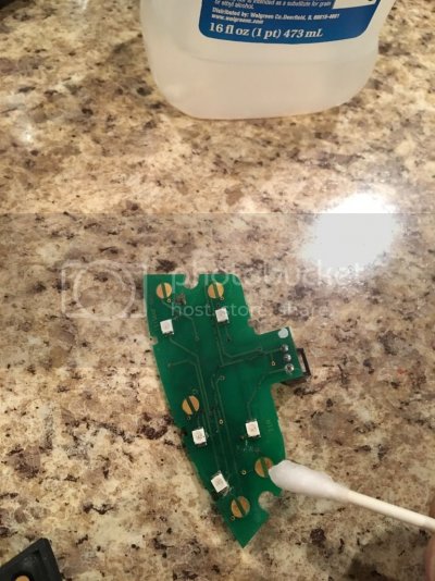

As you can see on this one there was some quite built up corrosion on the lower contacts which are "off" and "coast" which not uncoincidentally were the two functions that didn't work at all.
I used a swab with denatured alcohol and cleaned the board contacts as well as the surface of the button contacts:
