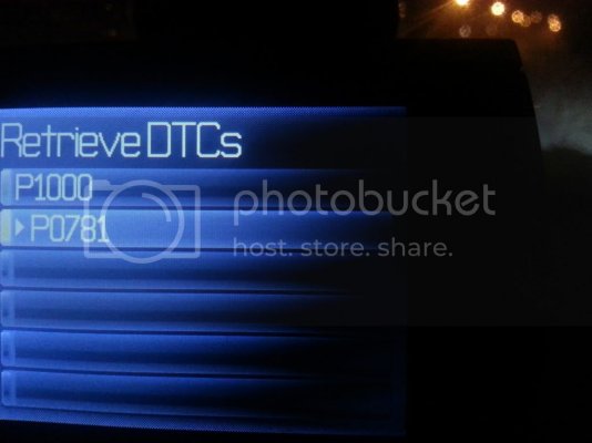

Just hopped in the truck today, out of the blue it wont shift from 1-2, I hammer on it it over revs and hits 3rd. it will not perform 1-2 shift. going uphill 3-2 downshift is normal. Is there a solenoid that fails I can replace? the od light flashed until I cycled the key, i wish I wrote down the code, it was like po1752? my best guess. If it happens again I'll get it for sure. Any common failures I can look into? for now I added some seafoam to the tranny in hopes it will free up a sticky valve. Fluid and filter have been replaced, fluid condition and smell is excellant

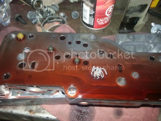

well good news, unfortunately I replaced the shift solenoid pack first and it didnt fix it, so I have a spare.... I got a transgo shift kit and a upgraded sonnax line pressure modulator valve. Took it all apart, and found the 1-2 shift spring in three peices on the main body. replaced all the springs, installed the upgraded parts and bingo. just like new but better!! Was quite please by how clean everything was, how little material was on the magnet. soooo happy dance :)

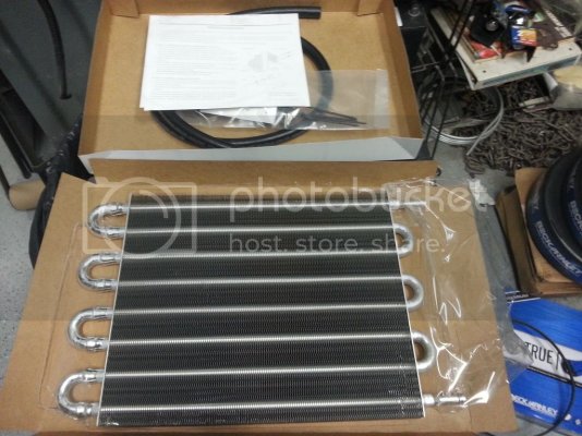

pulling apart tonight, about 1 in every 50 shifts it hangs in 2nd, i talked to my buddy at atlas transmission and he said the valves should move in the bores with no resistance, i know for a fact when i installed them and the new springs there was resistance. plan is to pull the front body dissassemble, clean the bores with special nylon brushes, clean, clean,clean and reassemble with some upgraded cooling goods

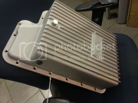

dissassembled and cleaned, i managed to pinch the little spring on the line pressure modulator last time, it was shaped like a piece of macaroni haha. anyways all fixed and upgraded cooling parts on. no visable wear or burs anywhere. one tip is to clean the topside of the tranny where the pan bolts go through, it holds a lot of road gravel and dirt up there, I had to chase a few pan bolt holes because of it.
