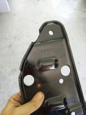

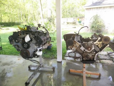

-The Engine mount plates had to be modified.
-The front timing cover for the Aluminum block doesn't line up with the Iron block. I used an 05 F150 STX front timing chain cover. It has the high mount power steering mounts like the Expedition.
-Everything needs to be swapped over except the block and heads.
-Expedition has 2 knock sensors in the valley, Fe block has one. I mounted the other behind the passenger head.
It was a hell of a job. It took me a couple months in my spare time. Everything I researched was wrong about the Iron to Aluminum swap.
