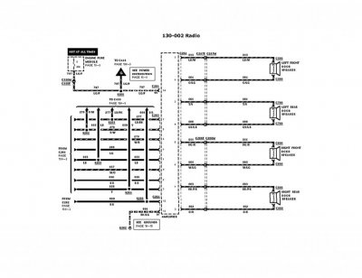

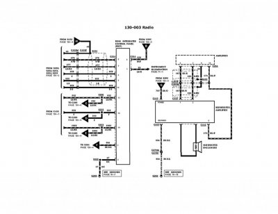

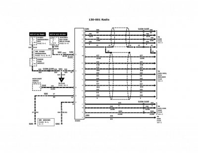

Hi jseales,
Yes, I can read schematics. What are you suggesting? Just trying to look for which wire to tap into in the radio.
R
Ronnie Cutler
May 22, 2017
Virginia
Thanks jseales. The black/pink wire is the one to splice the remote turn on to, the white/red left (positive) & brown (negative) for the left front speaker were spliced to the left input, and the green (positive) & white/orange (negative) for the right front speaker were spliced to the right input.
