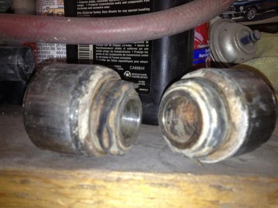

I have a large amount of play where the rear lower control arm mounts to the knuckles. You can lift the tire and it freely moves up and down 1/2" or more. Can the bushings be replaced on the knuckles?

Anything can be replaced... From what you are describing, it sounds more like a ball joint problem. Because the 2nd gens went to independent rear susp. it will have lower and upper ball joints just like the front. I would replace the lower ball joint, and that should take care of the play.

There's no ball joints: turns out its the lower knuckle bushing. Got 2 on order. Crazy play in the old ones lol.

They called it a bushing, but i'm sure it looks like that. I'll take pics.

Sounds good. I didn't mean to be rude and call you out on it being a ball joint haha. I had no idea they looked so different from front ball joints. Good luck with the fix.

All fixed. It was the balljoint, but it is a bushing. I'll post pics of the old bushings Monday. The were duuuunnnnn.
