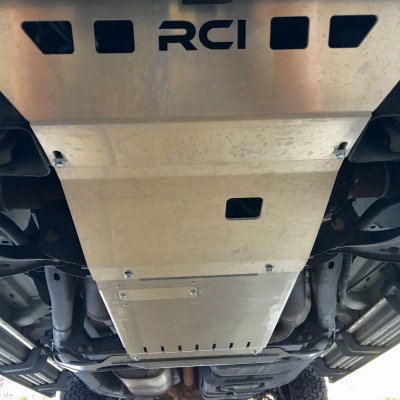

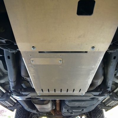

Below are my photos after putting on all three (2 plates for the Front Skid Plate and 1 plate for the Transmission Skid Plate).
I did NOT have to drill anything. All the holes lined up and matched perfectly. I installed everything in about 1 hour.
