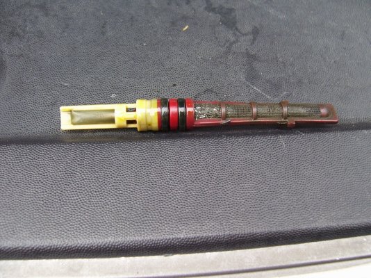

I hope you cleaned that valve before you put it back together.. there was a fair amount of YUCK on it....

""I hope you cleaned that valve before you put it back together.. there was a fair amount of YUCK on it.... ""
yeah, i let it sit in gas for a bit and took an old tooth brush to it then hit it with compressed air. I dipped it in some of the ac oil before installing it.
""And used O ring...not my FIRST choice.. was the donor car a R 134 system? ""
well, I didn't trust the o rings auto zone was selling and the donor was a near perfect match and it was what I had, it came from an 05 kia so it wasn't too old. the rest of the seals were in great condition and not hard at all, i could see no signs of age on them. any connection I opened got some oil on the seal before being re connected and I believe that helped a great deal.
