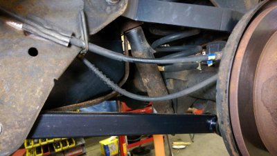

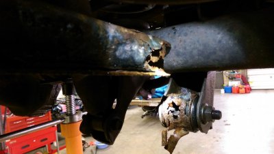

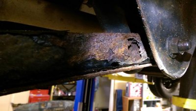

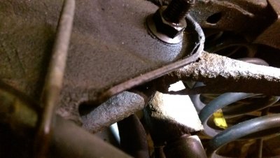

I have 2002 XLT and I love this truck for many reasons. It laughs at snow, hauls my entire family, feels great driving, and lastly teaches me new skills on a sometimes back to back basis.
Within the last 60 days my rear brake lines rotted out, starter died, exhaust after the muffler disintegrated, and found my trailing arm broken. And this morning picking my daughter up from preschool I blew a plug out. I had the Expy on the lift all day yesterday getting the arms and exhaust done, why didn't it happen yesterday when I was at the shop...

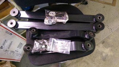

I installed the Heavy Metal upper and lower trailing arms kit.
The bolts supplied for the lowers were entirely too long and the shoulder was also too long. I used a grade 8 bolt to replace the one I zipped off and the rest I reused the bolts.
I'll work on the plug in the morning. Heading to my night job now.

WOW I haven't seen rust like that with the exception of a 68 Mustang GT convertable I bought a few years back that had sat under a tree and had a couple of Dovermans living in it for many years. Ended up parting that car out as I don't do rust.:puke:
