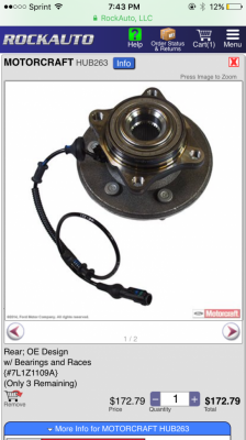

Yea stopped at autozone while I was out and about code says wheel bearing
6,511
3,124
you actually had a code for a wheel bearing? Did not know there was one
It was the "frequently reported fix" for the code which was to replace the wheel bearing.
