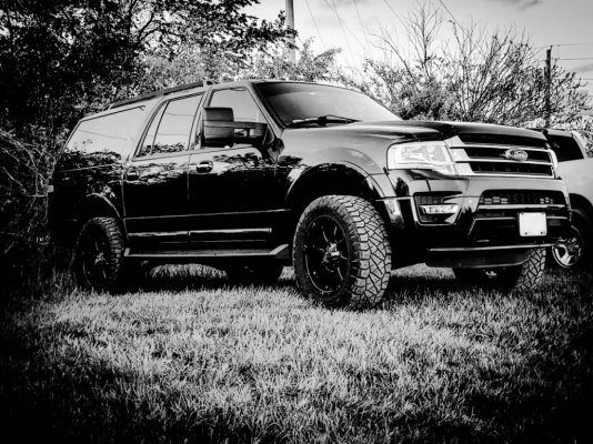

Wanting to add a transmission cooler to my 2015. Anyone done one to the 15-17 models. Factory unit with hoses costs me $175. Just wondering if there is one better recommended. 36770f07af6e51e1e4409f88a151c179.jpg
Sent from my SM-N960U using Tapatalk
What’s ur tire and wheel setup?
