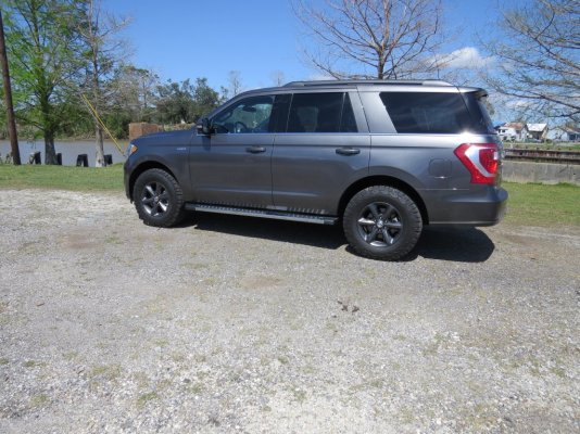

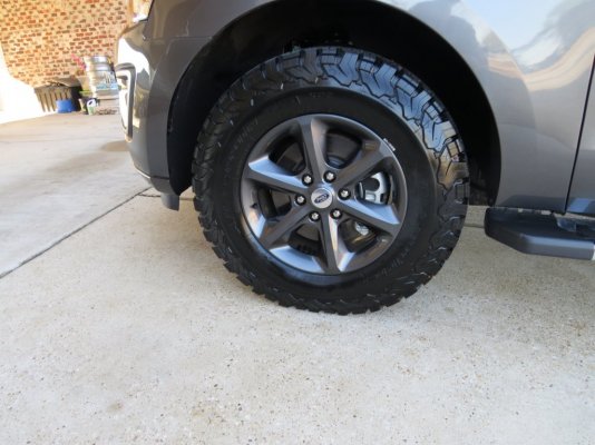

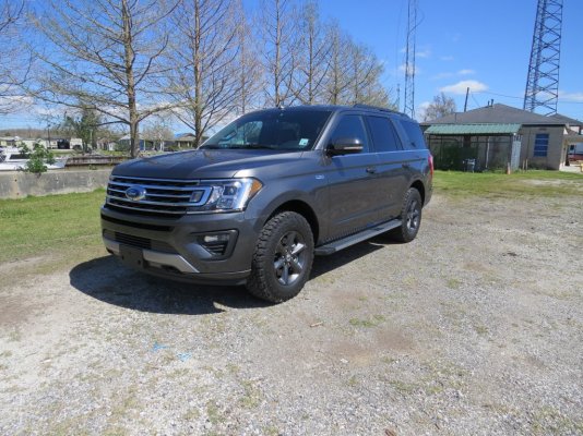

I've been running 42 psi cold in my BFG's. Firmer then the P rated Michelins I had but better for towing and puncture resistance. 1 to 2 mpg less than stockers depending on size. I'm running the 275x70x18's on stock FX4 wheels. IMG_6243.JPGIMG_6245.JPG

That's the tire I am looking at, I hadn't seen the 275/70r18 though, I was looking at 275/65r18 (stock). Any fitment or rubbing issues with that tire?
