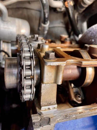

When you are turning the engine I hope you are using the bolt on the crankshaft/balancer and not the bolt on the cam sprocket. Snap either of those cam bolts off and you will add to a bad day.

Oh no. I thought that was how I was supposed to turn it. I think I turned the wrong bolt. I will have to look again tomorrow. I didn’t hear anything snap and I wasn’t forcing it. I hope I didn’t do what I’m afraid I did.

Yesterday I made an unsettling discovery though. I think I messed something up when I was turning the cam with the bolt on the camshaft and not the crankshaft. Yesterday as I was getting the piston to the top (I had the camera in there to watch it), something seemed off. Originally the lobe was at the top when the piston came up. Now it seems to be about 1/4 of the way off. The lobe is more at 9 or 10:00 instead of 12:00 if that makes sense. So I’m guessing this means I am going to learn how to rip into even more to remedy my mistake?
