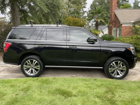

35” tires on a readylift 3/2 with +20s should fit. Go to customwheeloffset.com to the gallery and look at other expeditions to see what others have done. Gives all the specs on many other 4th gens. Your speedo will be off by about 6mph but with 3.31 and 35” tires a tune isn’t gonna give you much back, it’ll correct your mph and give you some power but nothing crazy with 91 octane. They are heavy, so unless you go ethanol don’t expect it to have anywhere near the same amount of get up and go.

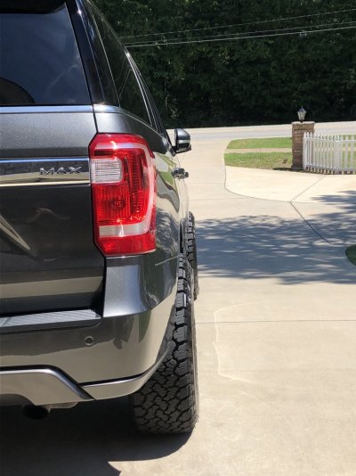

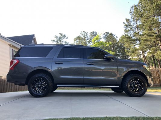

^same. I'm sitting on -12mm offset, LT285/65/18"x9". My E (10 ply) rated tires+rims weigh 95 lbs each (30lbs-ish heavier than OEM). I occasionally run the stock tires/rims. I have the 3.31 rear-end and am running a 5star tune. I can tell a big difference in getup & go going back to OEM tire/rim setup. I am running the lifted Bilstein struts (2"& 1/2" lift | front/rear). The next set of rims will be +18mm offset! -12mm causes this thing to wonder during hard turns under heavy acceleration.
