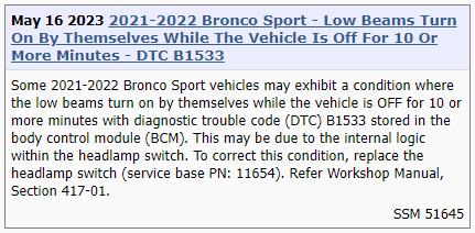

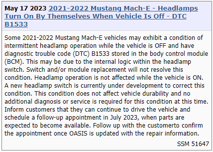

Read this: https://static.nhtsa.gov/odi/tsbs/2023/MC-10230964-0001.pdf
