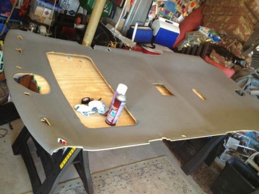

So it depends a lot on if you have a sunroof and what you have for a ceiling console up front. You will need to take out all of the pillar plastics, they all pop off. In order to get the b and c pillars out youll also need to unbolt the seatbelt which is easy enough to do. Then the ones out back near the trunk will also pop right off. You'll find some push pins out back under the plastic panel on the roof which will come right out. Once you have all the pillar pieces from front to back taken out, then the headliner should be held up by your rubber door trim, the dome lights, and the flip down sun visors (also sunroof trim surround and front ceiling console if you have them). The dome lights will come out with some screws, you'll find those after you pop their little plastic covers off. Once you have everything taken out, you should be able to slide it freely out of the trunk, but be very careful not to let it bend because its a cheap cardboard-ish material that will bend easily and leave creases in the headliner fabric. I did the full interior color swap on my truck in the spring and i should have some pictures on my profile, so let me know if you have any questions

So if it is the same as mine then youll need to take out all the pillars, front overhead console, sunroof rubber surround piece (held in with some weird glue that doesnt dry so just pull towards the center of the opening), backseat grab handles (bolts under the pop off covers), sun visors, 2nd and 3rd row dome lights, and the plastic panel on the ceiling in the trunk. I have 13" tint strip on the windshield so i deleted the sun visors with fiberglass and bondo, but other than that everything should be the same as mine.
