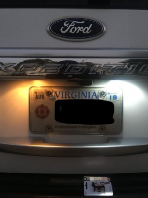

best replacement LED bulbs for tailights, license plate, reverse lights, and side view mirror. And what is this CANBUS free thing I hear about with an error code associated with LEDs if anyone knows? Thanks all

I replaced all mine with bulbs from Diode Dynamics and I'm very happy with them. You will also have to install the inline resistors to correct the fast-flash on the blinkers. If you have any questions, call Diode Dynamics. They have great tech support.

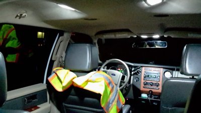

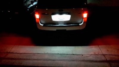

Amazon search:
JDM ASTAR 10pcs Super Bright 194 168 175 2825 T10 PX Chipsets LED Bulbs,Xenon White
$12.99 / 10 pieces
Tried posting a link but it's not working
Fits: front and midrow dome, rear plate, reverse, and front side markers
No errors no resistors

Amazon search:
$12.99 / 10 pieces
Adieu, they also went in your reverse and front side marker???? no problems? i have 4 left and this will allow me to upgrade that!!!!
I had a different set for reverse but they looked to be the same size...side marker is on aftermarket headlights but i think the socket itself is original

Basically your blinkers flash fast when you have a bulb blown. They have The same effect with led bulbs due to the resistance differences between and led and incandescent bulb. Typically you can install resistors to make the car think everything is fine but with newer models they are computer controlled so by changing the program it's will blink normal
Sent from my LG-G6 using Tapatalk
These arent blinkers we're discussing though...no CANBUS issues here that i know of, well either that OR the cheapie amazon set I referenced blocks canbus issues somehow
