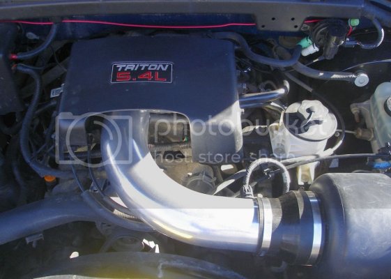

Some pics here: http://www.expeditionforum.com/members/43969-albums199.html
Bigger MAF & air intake
Opened up exhaust
S/C & Aftercooler
Oversized trans pan
Immediate improvement, esp bottom-end torque. Remember this is only a 6psi system compared to what Tom is running @ 14psi.
