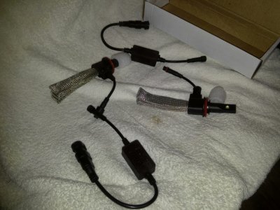

Like some others, it bothered me that my LED fog lights don't match the stock halogen headlights so
I bought a set of these LEDS that should match my LED fog lights in color and match the output of the stock headlights. I think that they will fit, the H-11 socket will be a match but didn't know they came with the little box of mini-drivers. We'll see but they were cheap enough that I won't be too upset if they don't work. 34 bucks for the set, delivered!

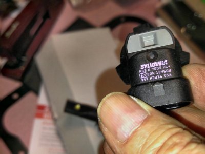

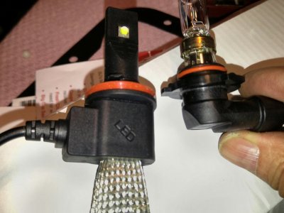

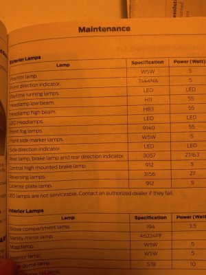

H11 on left, stock HB3 on right.jpg The information in the owners manual is WRONG! As the pic shows, the owners manual shows a H11 socket for the low beams. This is incorrect, it's actually a HB3 . The pic shows the actual lowbeam bulb I removed. Don't know about the '16's but on my '17, the manual is wrong. I triple-checked to be sure that the bulb removed really was the low beam and it was....the outside bulb for the projector lens. What a PITA! The pic shows the difference between the H11 LED and the stock HB3 Halogen sockets.

Was up at the dealer to get my permanent tags yesterday and showed all this to their Parts & Service mgrs...neither had ever seen this before but both agreed that the manual is dead wrong!

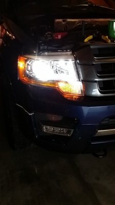

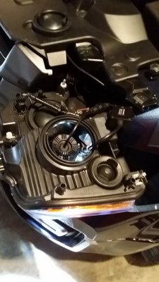

What did you do about the dust covers? I did install led to match the light color of the fogs. I'm a little concerned about the heat disipation. Any issues?20161223_171759.jpg20161223_171812.jpg 20161223_171759.jpg20161223_171812.jpg

You got the type with the separate box, in the other thread I told you that mine didn't have the separate box but don't worry about heat....it's one of the reasons that LEDs are so much more efficient than Halogens....they don't convert energy into heat like those superhot Halogens do....there is very little heat with LEDs so you will be fine with the setup you have. I would install the little box inside the nacelle, at the bottom so that it is out of the way and the stiff wiring should keep it from bouncing around.

Jeff thank you. I drove the Expy for about 1.5 hours straight and then took the headlamps assembly out to check and seemed to be ok. I am very happy with the outcome so far.
