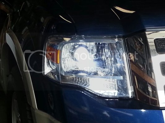

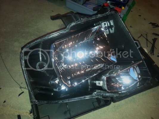

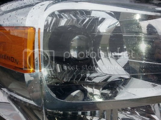

I just ordered what should hopefully be all the LEDs needed to convert all of the interior lighting as well as the license plate lights and the puddle lamps on eBay. Total investment into the project so far is like $27. If this goes well and when funds permit my projector retrofit, I'll also be swapping the rest of the exterior bulbs to LED. The front signals will be the switchback style. When parking lights are on they light up white and when the turn signal is engaged the white cuts out and the amber section flashes until the signal is turned off. Most of the I've got tracking information on 2 of the items so far and should start seeing them towards the beginning of next week.
