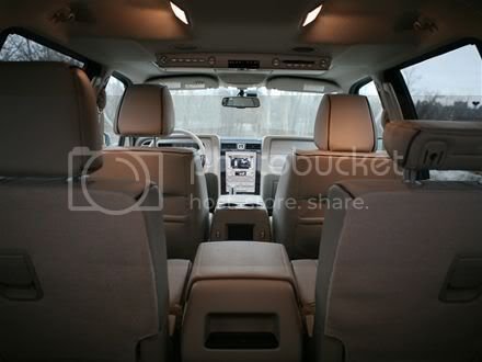

Yeah.. that would be me.. removed center seat and installed a Nav console. it's from an 08 Nav and I fabbed up some brackets for it. Color match in person is not as noticeable.. most people wouldn't know unless they looked hard. Very happy with the outcome.

Hmmm, is the installation of the 08 console different that the illustration I have above?

It's is an 08 console for a Nav - I paid $250 shipped for it.. not sure how great a deal that was/is, but I wanted it. Fabbed some brackets as it didn't come with any and it works great - back seat passengers are much happier.
